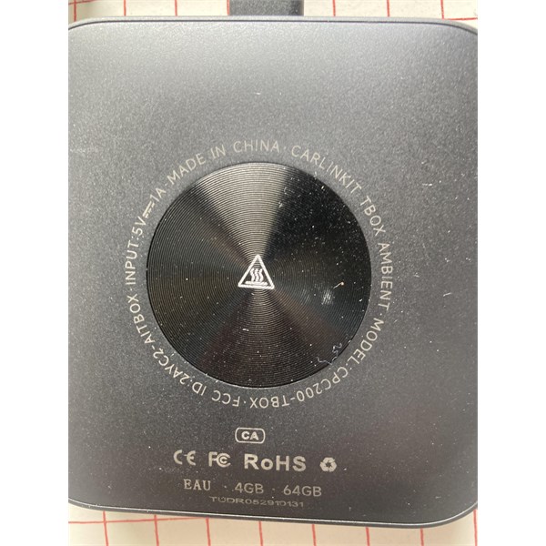

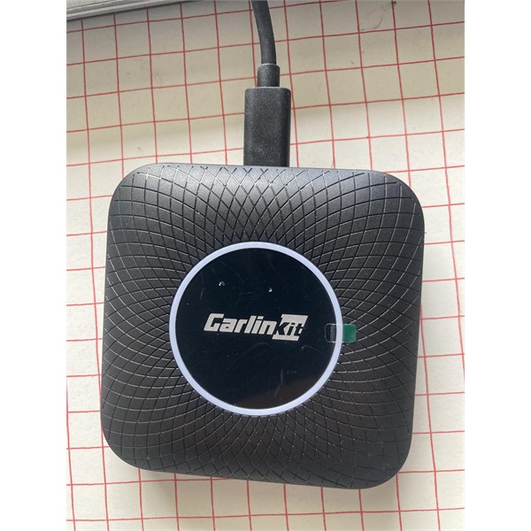

Sorry to hear of your problems. My experience was very positive and I have used the Carlink device in both a Ford
Ranger and a new Land Rover Defender. Both vehicles ran ExplorOz seamlessly.
Attached are photos of both sides of the device.

Hi Vic4wd,
Thanks, really appreciate your input and especially the pics.
This has confirmed that I purchased the wrong product.
Have sorted out the right one now and hopefully will have a positive experience.
