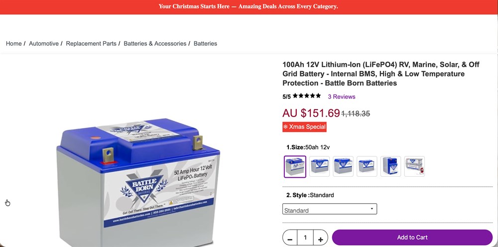

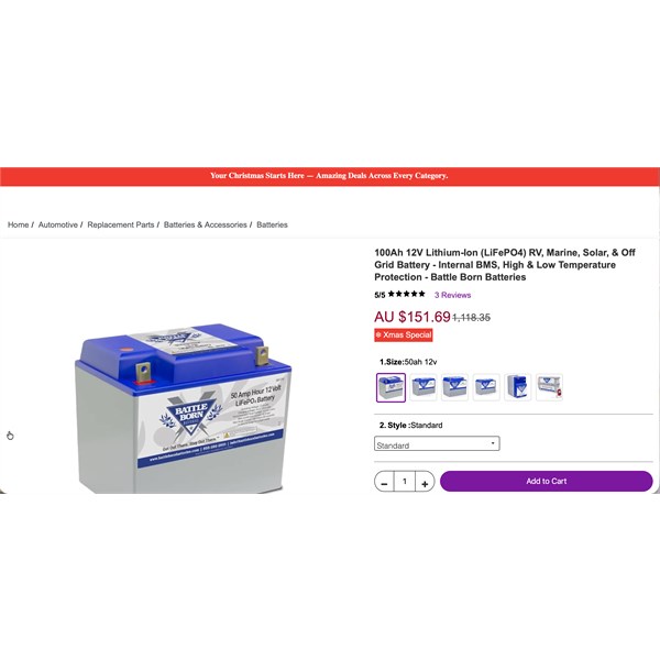

Follow Up By: Member - Cuppa - Friday, Dec 19, 2025 at 11:35
Allan, I googled as you suggested. A handful of sellers, purportedly Australian, showed up, but looking deeper they are either American prepared to sell to Australia, or have no stock. The only mention actually on an Australian site I could find was Outbax.com.au. But in their listed batteries there were no Battle Born, only their self branded items. Amazon Au don't have any either.
FollowupID: 930351
Follow Up By: Allan B (Sunshine Coast) - Friday, Dec 19, 2025 at 15:29
Well they were, but with Australia's consumer protection laws and retailer wisdom, perhaps the are not any more.
FollowupID: 930352
Follow Up By: Member - Cuppa - Friday, Dec 19, 2025 at 15:47
Allan, I think you will find that that company (www.melaviamart.com) are not based in Australia. In fact there is nothing on their web site to say where they are based & further searches warn of a probability that this is a scam web site.
FollowupID: 930353
Follow Up By: Allan B (Sunshine Coast) - Friday, Dec 19, 2025 at 16:15
Well that fits well with a scam product.
FollowupID: 930354
Follow Up By: Member - William B - Friday, Dec 19, 2025 at 18:18
Scam product or Scum product??
FollowupID: 930355
