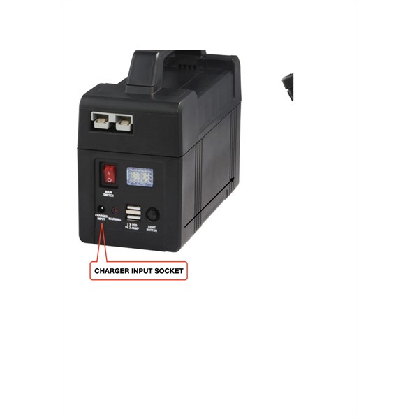

Wondering if anyone is using a Repco compact jump Starter and may know if it can be recharged via the Anderson plug socket when 240v power is not available. Repco staff dont seem to know - locally.
Seems a simple exercise to recharge either from the caravan anderson or the solar panel fitted with the appropriate regulator, but would feel comfortable if anyone can confirm that is acceptable.
I have the RCJS1200 model and looks a pretty handy sort of kit.
Thanks in advance
Regards - Phil

I doubt that you can charge the jump start via the Anderson output socket.
I note that the supplied AC charging adapter has an output of 15V 0.8A.
You could possibly charge via the existing charge socket from batteries or solar.
The battery voltage may be a bit low (ie <15V) but may work. You would need to make an appropriate cable with plug to suit in charging input socket.
Alternately you could use a small inverter to generate 240v for the adapter.

Thanks kgarn, I do have a 3000w inverter but felt it easier to use the Anderson if compatible.

Your jump starter will have a Lithium-ion battery in it. These are the battery types used in E-bikes and scooters and cause fires when being charged incorrectly.
I would advise that you only recharge your jump starter with the charger supplied with the product. Any other charger or form of charging may lead to disaster.

According to the Repco website it uses an AGM battery.Rcjs1200

That leads to further pondering, but will stick to the 240v / 12v lead from mains power or an inverter if needed for safety measures.

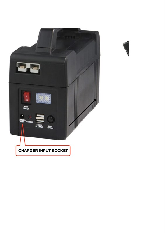

A quick look at the product mentioned by the OP shows it has an integrated Anderson plug and can't be charged any other way.
Mind you, with a small 12AH battery, I doubt it will start much more than a Kia Excel anyway.

Tony, take a closer look…………
