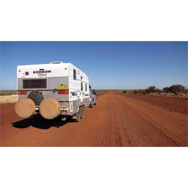

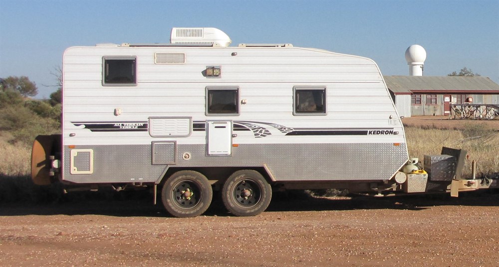

I have always carried 2 spare wheels on the back of my Kedron van.
Each wheel weighs 40kg. I am thinking of just carrying one spare to reduce my travel weight by 40kg.
I have travelled extensively on unsealed roads, Gibb, Tanami, Birdsville, Oodnadatta. Great Central, etc.. I have only ever suffered one occasion when I had to use one of my spares. That occasion was in the middle of the Great Central Road.
My question is : If you carry two spares for your van, have you ever had to use both spares. What were the circumstances.
I do carry tyre plugs, an inner tube ( to fit inside a tubeless tyre if needed) etc etc
My personal usual response to such questions is that it is always better to have just enough rather than almost enough.
What are your thoughts about a single spare wheel.
Regards, Ken

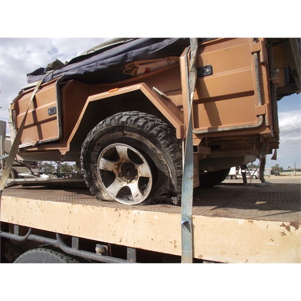

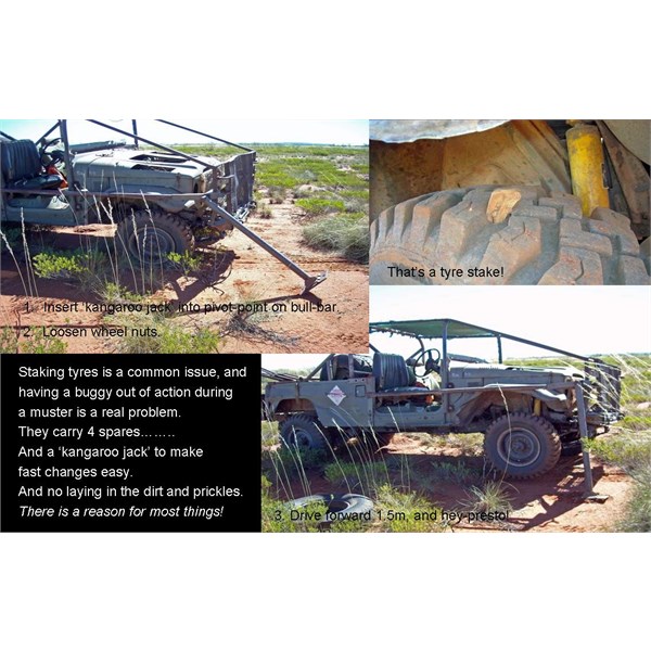

Agree but emphasise the use of a TPMS as a part of that strategy.

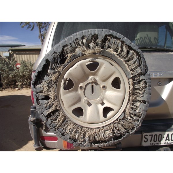

You can’t plug a destroyed tyre and often you don’t know you have a flat on a trailer until you are past the point of saving the tyre
FollowupID: 930507
Follow Up By: Allan B (Sunshine Coast) - Sunday, Jan 25, 2026 at 19:33

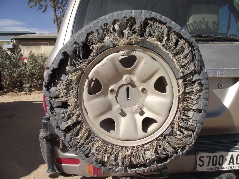

Like this one Alby?……..
And sometimes even on a car?…….

Peter, how did the friend with Porsche manage with 4 destroyed tyres? That is where my Rema kit would come into play.
And I have heard the rags & grass trick before but am very sceptical that it would actually work. Besides, who, needing rags & grass, would be carrying tools to remove and replace tyres?
FollowupID: 930499
Follow Up By: Peter_n_Margaret - Saturday, Jan 24, 2026 at 13:55
Alan, it was in Waikerie in the SA riverland. He went nowhere until he got 4 new tyres in from Adelaide.
I am not sure what a Rema kit could do with a tyre that has the side ripped out.
I am sure that filling a tyre with whatever you could find as a last resort would get you moving at walking speed. Choose the least loaded position.

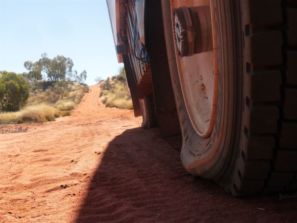

Reply By: Peter_n_Margaret - Saturday, Jan 24, 2026 at 08:16
Wider tracked vehicles are likely to have more issues than those of 79 series width.
This was a Dodge Ram on the Canning.
The OKA and Canter had no issues.
AnswerID: 648887

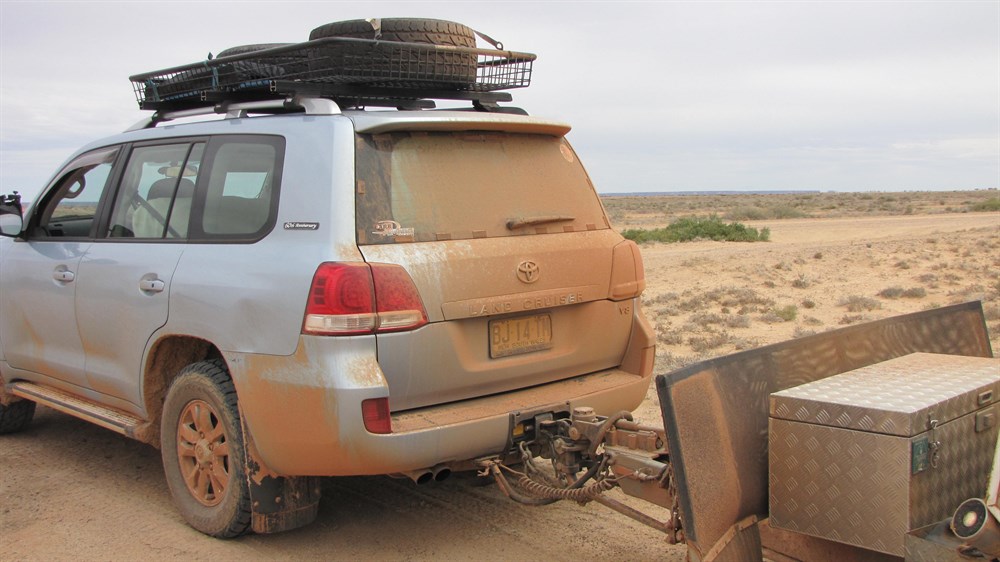

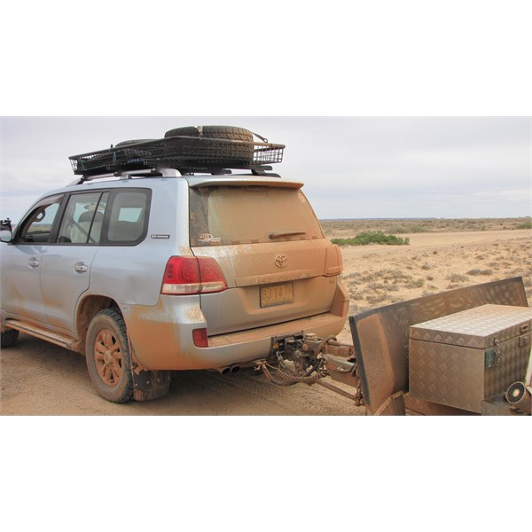

Reply By: kgarn - Saturday, Jan 24, 2026 at 11:29
Thank you to all those who responded to my post about spare wheels.
The reason I am considering carrying only one spare for my tandem axle van is that I am close to my ATM of 3500kg. I have already replaced my original 3x AGM batteries with lithium and replaced my 2x 9kg gas bottles with 2x 4.5kg. I have previously carried spare tyre carcasses
By reducing discretionary items and weight it gives me more headroom to carry other items and still remain below ATM. And as mentioned by one respondent losing 40kg off the back of the van is a good thing for stability.
I do carry tyre plugs, compressor, etc. The tyres are Toyo Open Country AT3
The wheels are the same size as my LC200 and the van wheels would fit the LC200 but LC 200 wheels would not fit the van because of offset. I am thinking that in an emergency I may be able to use a wheel spacer to enable the LC200 wheels to be used on the van temporarily. I will have to do a bit more research on this option. I know they are illegal !
Ken

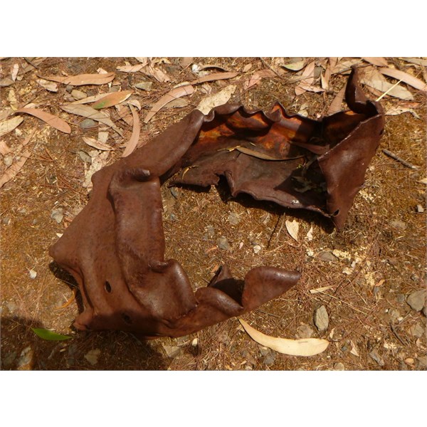

One particular location where tyres are at risk of sidewall penetration is on well-worn tracks with vegetation growing close to the track. The tree roots grow out to the wheel ruts then become broken off and project horizontally like spears into the ruts just waiting for an innocent passing tyre. Most will deflect but eventually there will be one pointing in just the right direction to penetrate your sidewall.
Not a lot you can do about it other than a keen eye for obvious dominant ones and steering to the opposite side but that may then place you into another peril.
I know of two instances of victims but fortunately I never fell foul of such peril and that may have been because the Troopy has a narrower wheel track dimension than many vehicles and so the tyres were further away from the rut sides.

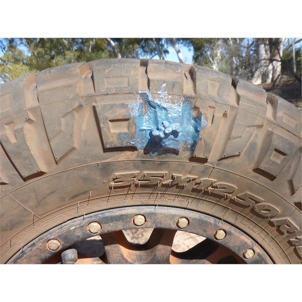

Glue Tread kit could provide a temporary solution to some side wall damage that cannot be plugged.
Have used it on a camper tyre with a 30mm sidewall cut during a Cape York trip with success.
https://www.gluetread.com.au/products/external-patch-kit

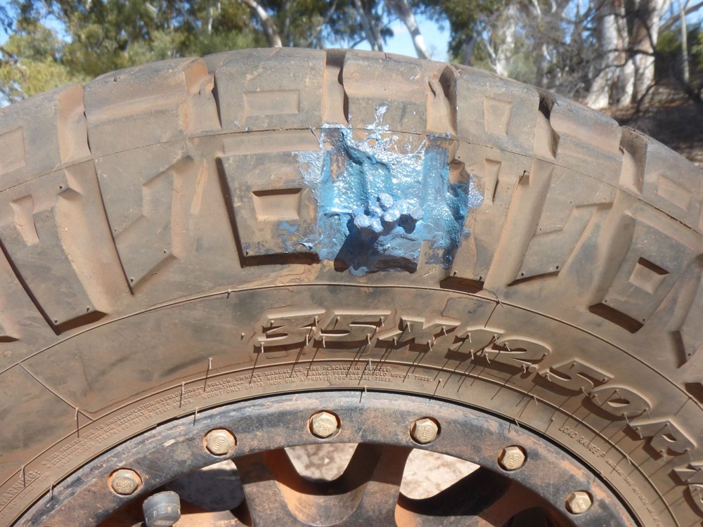

Moreover, if the size of the puncture is more than 6 mm in diameter, a repair isn’t permitted at all.
However, if you were to obey those Rules then you may be stuck forever on some remote location.
So we are not going to bother with those silly rules, are we?
But I would offer a caution that any repair to a sidewall should be followed by a speed limit of maybe 60kmh, off road or highway. A blowout at any higher speed could be difficult to handle with a heavily loaded vehicle and especially if towing.
I view that "Gluetread external patch kit" referred to above in alarm and pray that the user is not coming toward me on the road.

We worked on a cattle station for a couple of months back in 2008. Just for fun.
The mustering buggies typically carried 4 spares each when mustering. Having a buggy out of action during a muster, even for a short time, could be a real problem. Then it was someone's job to spend a day fixing all the flats at the end.

Follow Up By: Allan B (Sunshine Coast) - Saturday, Jan 31, 2026 at 10:39
Yes Peter, and Len Beadell said that he spent each evening repairing staked tyres.
But generally, most of us do not drive wildly cross country.
But of course there are exceptional people. lol
