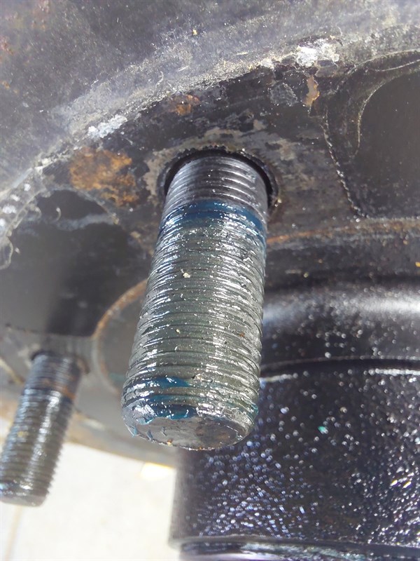

Good morning all. I'v been in maintenance mode in the last week & getting the caravan ready for Easter providing we can still afford to travel then.
Have a 2020 Jayco journey Outback . amongst other things I have been upgrading the drainage out of the shower which was pretty poor for getting water drained out of the shower , we would be standing in water during a shower :( Upgraded it to more conventional 40 mm PVC drainage .
Checking over the wheel bearings this morning I noticed that the wheel nuts were well greased to a point of wet..
I know we don't like to have them dry and grabbing locking up , but how much is too much? I was wondering what others do, maybe a little dab of copper Grease.
Love to hear what others opinions are and any other maintenance hacks you may carry out before a trip away.

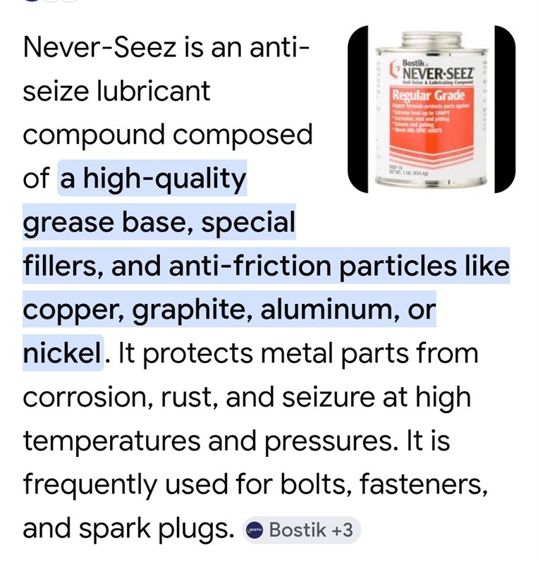

Follow Up By: Member - nick boab - Sunday, Mar 15, 2026 at 15:42
Nerver seez tutorials
FollowupID: 930689

Reply By: Member - nick boab - Sunday, Mar 15, 2026 at 15:29
Before I wiped the excess grease off
AnswerID: 649033
Follow Up By: Stephen L (Clare) SA - Sunday, Mar 15, 2026 at 16:35
After watching a YouTube video, looks like I have been wrong and we all should just be using nothing, there is far more into it.
Smile like a Crocodile
