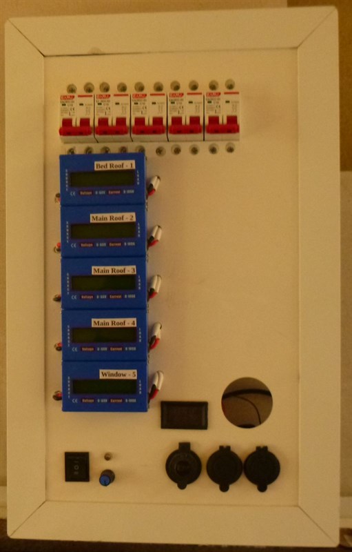

Follow Up By: Peter_n_Margaret - Monday, Apr 27, 2026 at 00:13
Allan, I posted it because some here may not be aware of how simple it is to avoid complying with the Standard, if they wanted to do that.
With modern solar and batteries it is relatively easy to be totally off grid. If you can be off grid for a week, you can be off grid forever and avoid the Standard, if you wished.
My current OKA motorhome has no external connection (and never has had), so it does not need to comply, but adding an external connection now would be a significant task.
The new build under construction will also have no external connection so it does not need to comply either, but I will follow the standard wherever I can and when it makes sense to do so.
For instance, I have changed from single pole to double pole circuit breakers on the solar input cables. A simple task. I am sure there will be other things like this that are simple additions that make sense and would make adding an external connection later a lot easier, if for some reason I (or a subsequent owner) decided that was a good idea.
FollowupID: 930942
Follow Up By: Allan B (Sunshine Coast) - Monday, Apr 27, 2026 at 09:47
Ah yes Peter. I now understand and completely agree. Avoiding an external electrical connection affords a great advantage in freedom from AS 3001.
I note though that you have "changed from single pole to double pole circuit breakers on the solar input cables". I cannot see any requirement for that in the Standard. 5.5.2.2.3 states "Overcurrent protection devices shall be installed at the renewable energy source in the positive conductors". And Figure 5.6 shows a single pole breaker on the solar input. 5.6.1 states that "A fuse or circuit breaker shall, as a minimum, be installed in each unearthed pole of each circuit connected directly to a battery…."
As it would be normal to have the battery negative connected to chassis this would constitute a "earthed pole". So have I missed something about "double pole circuit breakers"?
I am really glad that my construction and certification of the Sprinter was complete before the implementation of this Standard.
I only added the battery sealed enclosure in case some future picky prospective buyer pointed out that the "battery must be enclosed". Doh!
FollowupID: 930948
Follow Up By: Peter_n_Margaret - Monday, Apr 27, 2026 at 10:16
Can't remember why I went double pole, but it seemed like a good idea. :) I had no isolators at all before the new standard.
My solar connection is a bit different. I will install 5 x 430W light weight semi flexible panels with a small capacity Victron controller on each panel which add up to a similar cost to one large controller, but provide redundancy and shade protection and allows me to monitor each panel performance individually.
This is a sub panel that is before the controllers.
EDIT: DC double pole circuit breaker
FollowupID: 930951

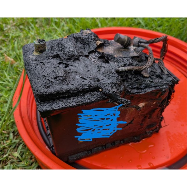

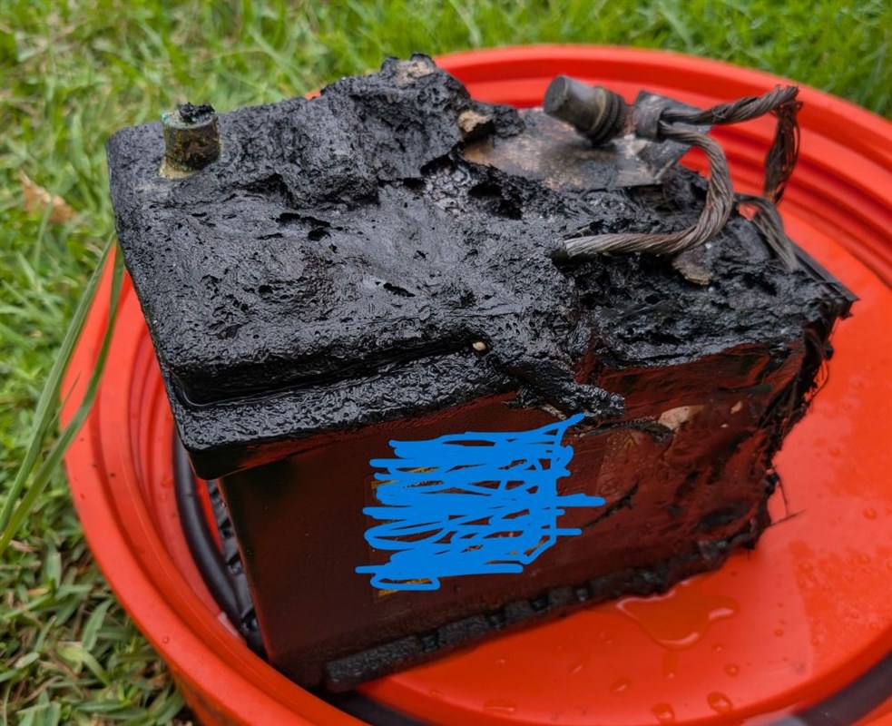

I suggest that it is a bad idea to make fundamental decisions based on a non-official summary that is quite old now. I would suggest that AS3001 (2022) makes no distinctions or exemptions, so it is a moot point. I cannot imagine that the standard excludes "lithium iron", but includes "lithium ion" AND lead acid, but it does not matter what you or I think. Ask the authorities for a clear understanding or buy the standard.
Personally, I would not put any battery under a bed.
And just for completion, this was a LiFePo4 battery with a built-in BMS. It had been totally disconnected for 3 days before catching fire. It was removed and put into a drum of water. It was still bubbling 2 days later. The vehicle was written off.
ps..this photograph is copyright.

Peter,
To be clear, was the battery the cause of the fire, or was the fire started by something else, and was just involved in the fire?
Do you have a copy of the official report on the fire?
FollowupID: 930909
Follow Up By: Peter_n_Margaret - Sunday, Apr 26, 2026 at 09:31
The battery caused the fire.
The report has not been publicly available. The vehicle insurer made full payment.
FollowupID: 930911

Peter,
If the actual LiFePo4 battery was the cause of the fire, and not faulty wiring etc. it would be the only recorded fire started by a LiFePo4 battery that I know of. Not that I profess to know the cause of all caravan/battery fires, but given the preponderance of fires started by Lithium Ion batteries, this would have made headlines, certainly in Australia, if not world wide.
Until the official report on this particular fire is published, it is still only hearsay, regardless as to whether the insurance company paid up or not. If the fire was not caused by a deliberate act or negligence of the owner, then the insurance company would have no reason to not “pay up”.

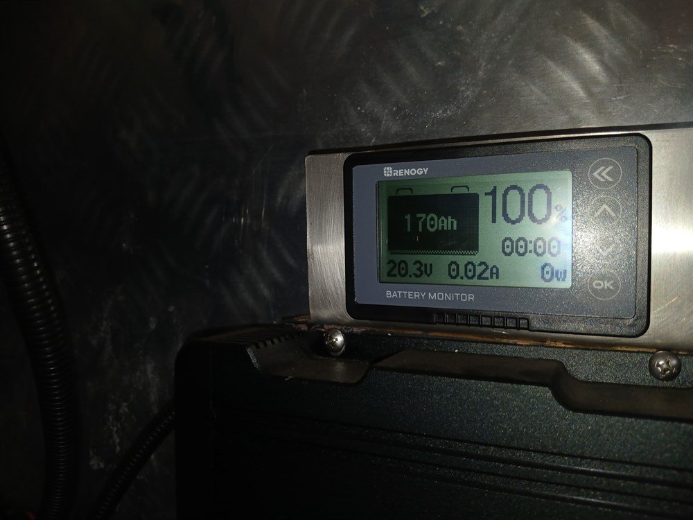

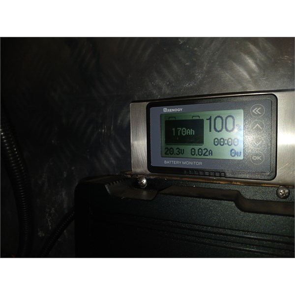

Follow Up By: Member - FLNGO - Monday, Apr 27, 2026 at 07:42
Hi Batt's,
Could this be a monitor issue? Did you check the over voltage at the battery terminals with the multimeter to confirm the battery was the issue?
My understanding is Renogy BMS should have cut off at approx 14.8V.
FollowupID: 930945
Follow Up By: Member - LeighW - Monday, Apr 27, 2026 at 08:50
Peter is the BMS in the battery, if so then maybe it has isolated the battery, once the battery is removed there is nothing to hold down the voltage of a faulty charger for instance so the output can get very high.
FollowupID: 930946
Follow Up By: Batt's - Monday, Apr 27, 2026 at 09:28
No I didn't test it with a multimeter at 20v I disconnected it straight away and took it out of the canopy I didn't think it was a smart thing to do go back inside get the multimeter and check it as something could have happened in the mean time.
It went up to 18v I forget someting like a few days or more before that so I put it on a 240v charger it done it's thing and after a little while all was good so I connected it back up and it was fine. I kept a check on it for days I started running the fridge off it all good but then one day it was 20v so not mucking around with it again it was only around 2 1/2 yrs old also the previous Renogy only lasted around 15 months. I pulled all the Renogy monitor etc out and have bought all Kings gear now to try.
FollowupID: 930947

Follow Up By: Allan B (Sunshine Coast) - Monday, Apr 27, 2026 at 10:06
Good point Leigh. I cannot imagine a connected battery rising to 20 volts. And if the BMS has isolated the battery then the monitor would be reading the charging supply voltage, not the battery.
FollowupID: 930950
Follow Up By: Batt's - Monday, Apr 27, 2026 at 10:24
I imagine when the BMS isolates the battery the monitor turns off and has a blank screen which in this case at 18v and 20.3v it stayed on.
Back a few yrs ago in cold weather at -3c the battery turned off and the screen went blank and had no power to it even when pushing the buttons. The monitor screen only came back on when I put power directly to the battery too wake it up.
