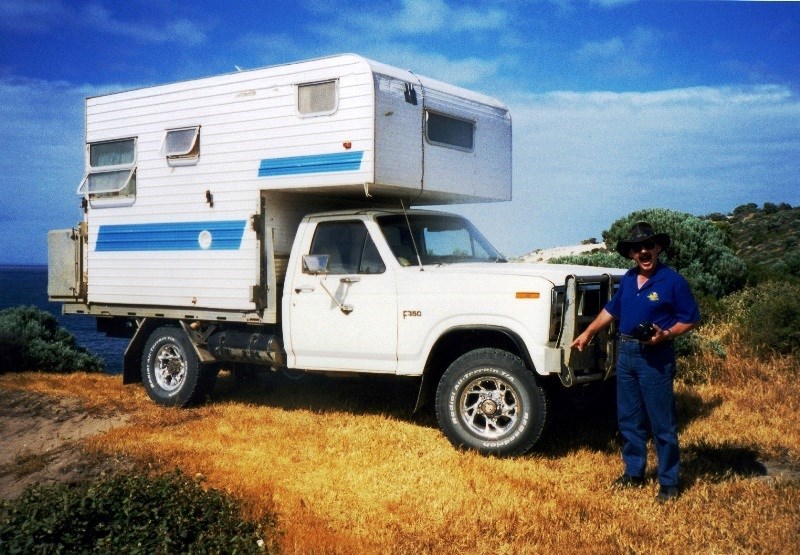

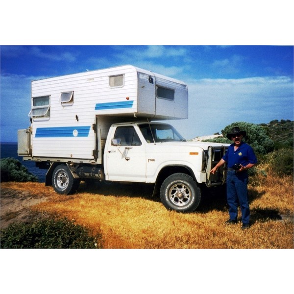

We had a slide-on for about 10 years.
It was a pain to get on and off, so we left it on the tray so it was ready to go at a moments notice.
It was my daily driver.
After a few years, I bolted it permanently onto the vehicle. That allowed a registration change from truck to motorhome which reduced the rego cost significantly.
We had a great time with that vehicle, but I would never have a slide-on again.
