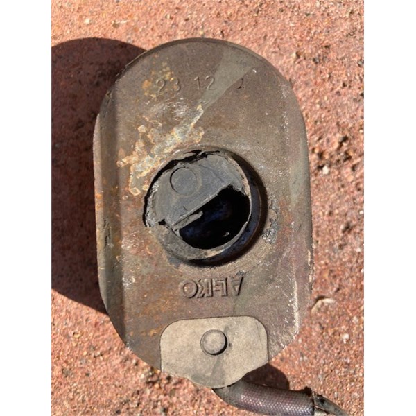

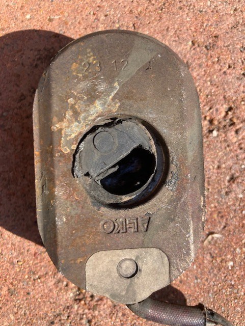

As I complete another underbody grovel beneath our van, it may be of interest to consider this brake magnet saga. Bought the 1.4 tonne Goldstream Explorer ST in Feb 2016 towed by an R50 Pathfinder with Hayman Reese brake controller. 5 years old so call it 10k km travel. Put 11,000 km on it at 20% dirt before a visit to Blakeys Brakes in Mareeba returning from the Cape in Sept. $680 worth of new shoes, magnets and labour. Call this set 2. Brakes now working well. 2 years later in Kalgoorlie and 20,000km more with 5,000km dirt so 25% of travel. 4WD is now a 120 Prado with a Redarc controller. Martins trailer parts in Perth shipped in 2 brake plates complete with set 3 magnets, shoes, springs etc. $450 plus $100 labour plus my own. Off we go again east across the Nullarbor to home.

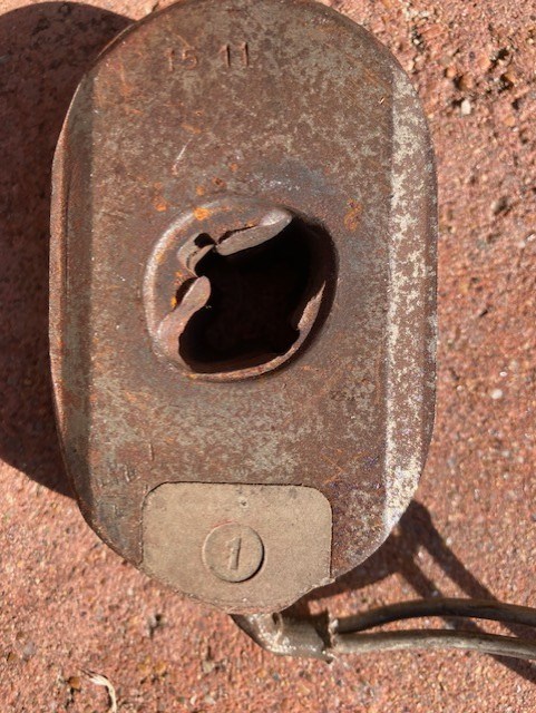

Sept 2019 and a broken wire  after 14,000 km on LHS magnet is the culprit. The wire had failed where it entered the body of the magnet (see pic) so was irreparable. Limp into Brisbane and $75 for new magnet and  full brakes restored. March 2021 after 27,000km and 10% dirt its a brake shoe set + labour at $400. More new magnets for set 4. Got new bearings too after 54,000km. May 2022 in Katherine, new magnets -set 5-after the last lot did 25 k km each at 20% dirt. Next is 2024 and 20,000 km later (5% dirt) after Jayco in Albury stayed open after 4pm  on  NYE 2024 to sell us a pair for $180. On 1-1-25 it's a 2 hour job to swap them out and continue the holiday. Set 6

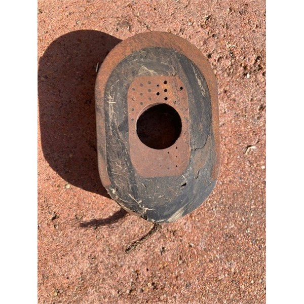

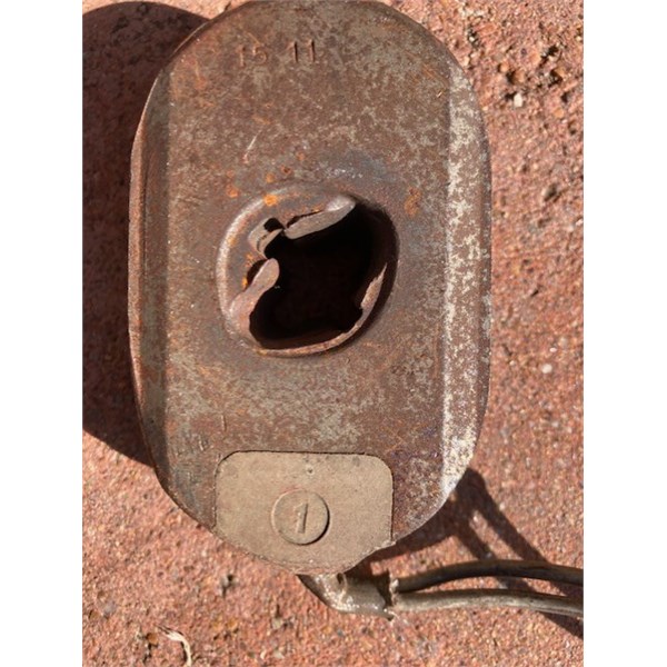

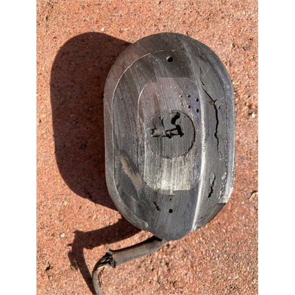

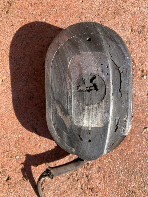

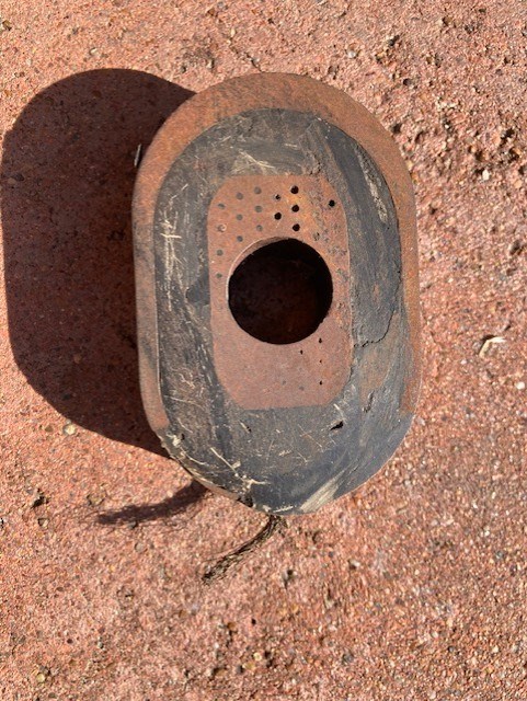

And so it is May 2026 and another 24,000 km (10% dirt) of towing has been done. 6th set is kaput. LHS has a severed wire and flogged out plastic centre. RHS OK in that respect, but is open circuit so no magnetism. So off to Carasel Trailers, $180 spent and the 6th set of magnets fitted.  The pix below show the sad story. I was thinking this is excessive wear with the average magnet life about 20,000km.  But maybe this is actually a good distance for what and how I drive? The ratio of dirt to tar surfaces has also been  considered. So, kind readers, I await your responses.

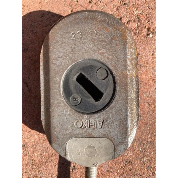

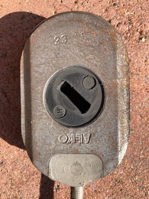

You are certainly have not had much fun there Warrie...there is one comment I'd like to throw in....I am referring to ALKO systems...to my knowledge two types of magnets are offered, standard and off-road, I seem to recall the difference is the material in the centre of the magnet, the standard being of metal, off-road a synthetic material. The latter designed to withstand the vibrations of corrugations.

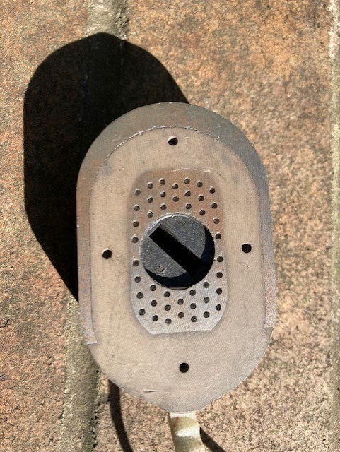

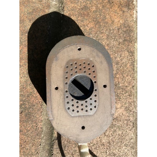

Another nightmare. Some say that white wires are off road magnets and green for on road. But I agree that on road have an X shape in the metal in the centre of the magnet. A pic shows a flogged out example. The off roaders have the plastic insert which can fail as the pic shows. Supposedly it is this better for rough conditions. Perhaps off road vans with disc brakes last longer. More input needed. Another point is that the ALKO $90 magnet now has to compete with Bunnings and Supercheap who sell a copy for $51!

Hi Warrie, I cant suggest anything that others haven't said re possible causes. And theoff road magnets like in pic 7 will last alot better than those with a cross in the middle, but I can say that the mantscin the 10" brakes we had on our Tvan certainly lasted far better. In gnarly downhill off road situations I regularly turned our brake controller to manual mode with braking force turned up high so I could just very lightly touch the car's footbrake & use the braking on the Tvan to slow us rather than risking locking up the car's wheels. In 10 years of Tvan ownership (& a lot off road) I only changed the magnets once & none looked as bad as yours, although the old ones had worn at a bit of an angle. I replaced them with aftermarket non alko ones & had zero issues with them.
