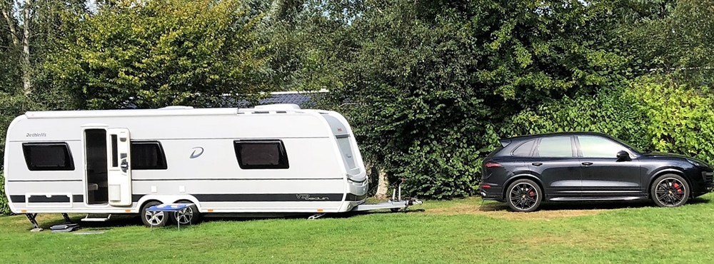

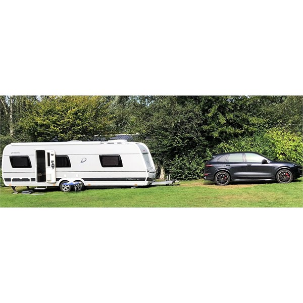

I have a Dutch friend who tows this 32ft caravan behind his Porche Cayenne.
He claims to have towed it non stop from Holland to southern France (1,100km) at an AVERAGE speed of 100kph (cruising at 130kph).
We 'like' ball weights of 10% in Oz. The Europeans like 5%. Caravans are relatively rare in Europe, many more travelers use motorhomes.
This is my pig trailer.
It probably weighs about 2T in this configuration (lots of fuel and water onboard). The tug weighs 6-6.5T. Note that....... :)
It has low yaw inertia and a longer than usual draw bar. Ball weight is about 20kg (I can lift it on and off the hitch), that is 1%. I tow at whatever speed I would use if I was not towing.
